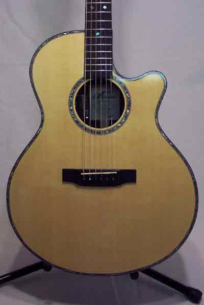

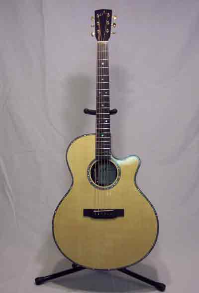

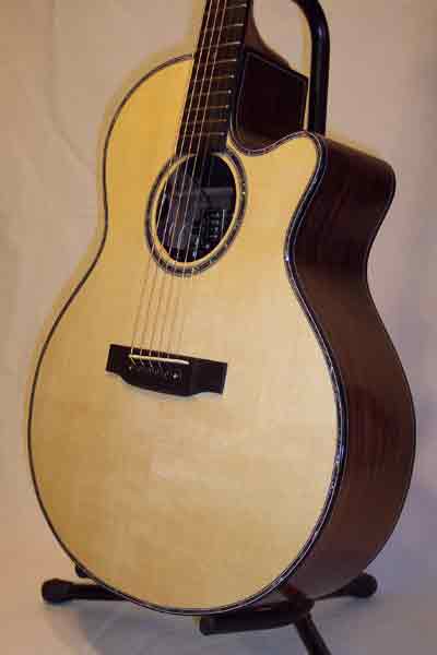

Well I just finished up the First guitar built using some of the Lutz Spruce I got from Shane at High Mountain Tonewood and I am very Impressed. The guitar goes out tommorrow (Customer Is driving all the way up from Minniapolis to get it) but the sound and the beuty of this wood is really something. Sound wise I can't believe how great it is. This is probably the best sounding guitar I have ever built, loud, rich open tone and it looks beutiful too. I didn't try this wood befor because of all the hype built up by someone else selling it but I am going to start recomending this stuff to customers. Here are a couple of picks of the guitar.

Sorry the picture didn't turn out well. Lost quality when I tried to reduce them to post here.

Wow, Richard, that's a fine looking guitar! I can just see the "soft curl" that Shane was speaking about. Do you have enough of his tops to know if this is pretty consistant top to top?
Again, very nice guitar.

Well, I'll add to the chorus -- that's a mighty fine looking guitar. I gotta ask, though -- is the body one of your own designs? It is really sweet looking.
I too am a big fan of Lutz. Tell ya what, it works fantastic for classicals, too. Who needs Euro when you got Lutz to build with?

Thanks michael, I acually think I might like this better than red spruce even. Time will tell. The body is my version of the Gibson J-185. Same basic shape and bracing but just a little smaller. I call it my small jumbo or SJ model. Dimensions: Body Length 20-1/8” upper Width 11-1/2” Lower Width 16” waist 9" Max. Depth 4-3/4”.
